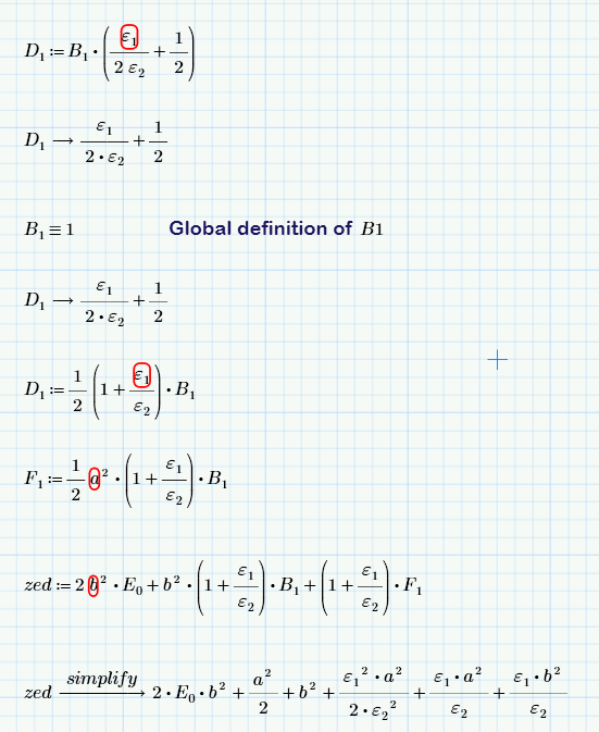

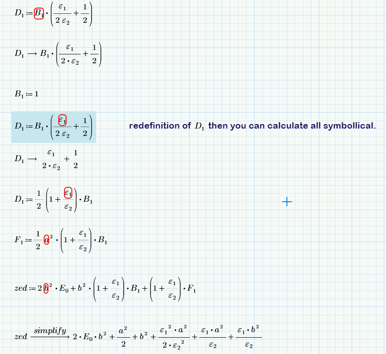

Hi Thomas,
to get a symbolic result by given B1, you must recall the Function D1.
if you define B1 as "global Definition" you don't need to recal D1:
Best Regards, Volker

June 9, 2017
Hi Thomas,
twolowiec1-VisitorAuthor
June 9, 2017
Thank you! That works perfectly. I'm coming from Mathematica, so I'm still not clear on how things work.

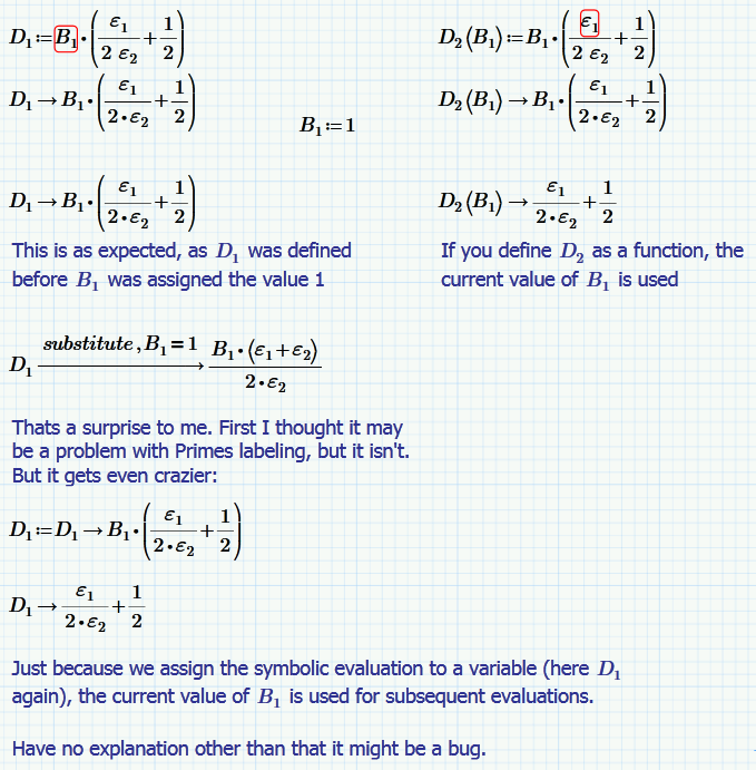

June 9, 2017
Indeed some strange effects. Guess we can call it a bug in the symbolics!?
June 9, 2017
No Werner, it isn't.
It's the kind of definition variables.
Gruß, Volker
June 9, 2017
Guess no.
If an expression (no matter if typed in or stored in a variable) is evaluated symbolically using the substitute command, this command has to work as it should. The different handling of an expression stored in a variable and an expression typed in manually is not as it should be (while it may be explainable by the way a symbolic expression is stored internally).
