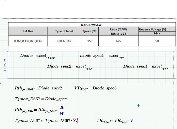

I need some help regarding the unit °C in prime 3.1. In fact, when I extract the variable " Tjmax_D367" from an excel table created in Prime3.1 and when I want to define its unit which is °C, It doesn't work. The error is: "This value must be a scalar or a matrix"
When I try it with the other variables extracted, it doesn't work too even if  The unit "V" and "K/W" work fine.
I will really appreciate your help,

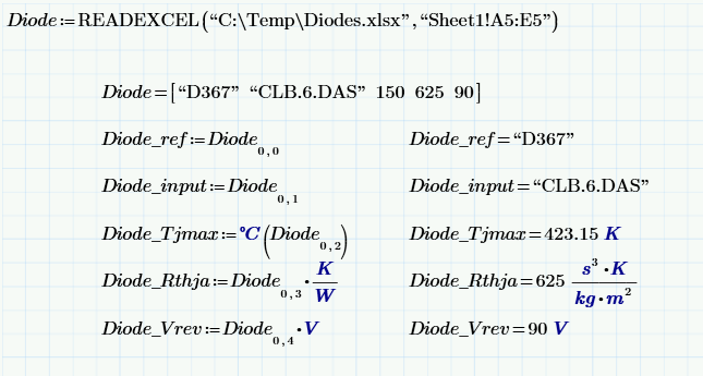

That is because, funny enough, degees C (and degrees F also) are functions, rather than units.
Here is how it might work:

Luc is correct.  You can also achieve what you want by typing a number before the °C, and then changing the number to your variable.  It would look like this:
note there is no multiplication between the variable and °C

Better
Temp:=150
Temp:=(Temp+273.15)*K
Temp=150°C
