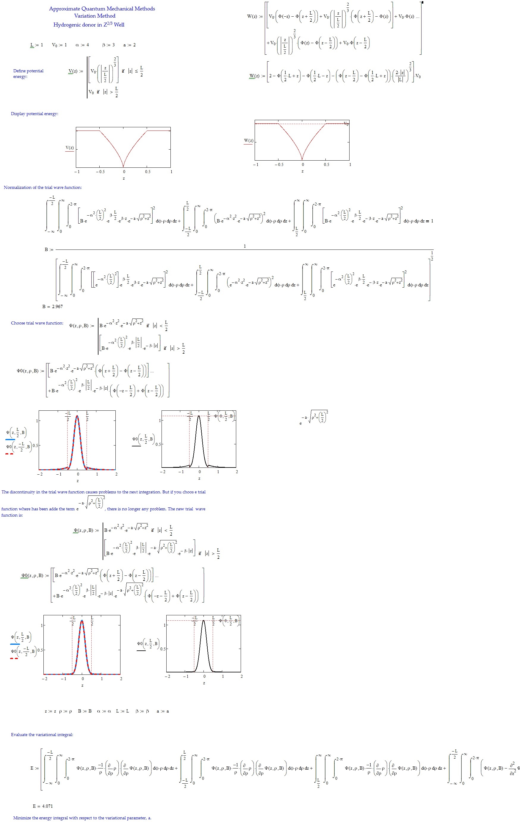

Hello to all,
I hope I can get some help here. I created a worksheet in mathcad for variational method.
Actually I am know only the basic about mathcad. In my worksheet , the minimization couldnot be able to do,
it take too much of time to do the minimization. Finally I am not able to get the answer.
So please see my attachement and help me to get the answer.
Thank you

Have you ever tried to evaluate your function E(a) for any single position of a?

Yes, I have tried that. But the forth term of E, which shows some error.
so coudnot get the answer. is that a problem for minimization?. If it means What shall I do? see the attachment i have tried for a=2.

I've simplified your integrals as much as possible; replaced them by discrete summations (with a really coarse resolution!) ; and they still take a while to evaluate! See attached. Incidentally the kernels of your inner integrals in E are independent of the variable over which you are integrating, so these inner integrals can just be replaced by 2pi.
See attached.
Alan

you replaced -Zinf by 2 and Pinf by 10. But in my problem it should be infinity only.

Yes, as it stands you will probably have to wait for an infinite time for the program to work if you use infinite (or very large) limits. The important question is: do the results change as these limits get bigger? Once the results stop changing (if they do) then you can safely use finite limits.
I did a little more work and simplified a few more things in your worksheet - see attached. Now you can use slightly larger limits and increase the resolution of the discrete sum representation of E (again, you need to keep increasing the resolution until the results don't change).
Calculation speed has increased, but is still fairly low!
Alan

perhaps modifying your trial wave function (without discontinuities) you can obtain some results as in the following immage:
PS: you have to modify the normalization integral.
