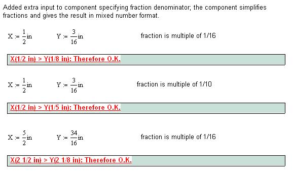

collab+-+14+12+04+fractions+02.JPGDo you mean something like the attached?

Dec 4, 2014 6:01 PM UTC
