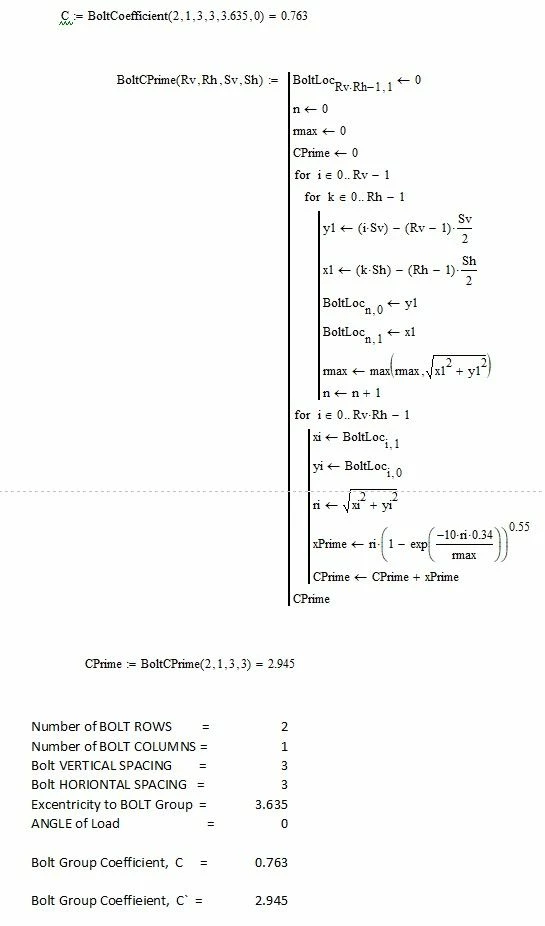

In the time it takes to faff about with Windows and Microsoft 365(Excel) settings it is easier to simply replace the two macros with Mathcad functions for C and C' thus ellimination the need for the excel embedment altogether.  Just translation of the macros line by line.
Here are the two macros in the file provided and they have been checked as working as long as you don'[ enter 1 x 1 bolt groups.

Works great.  Thanks tons!
