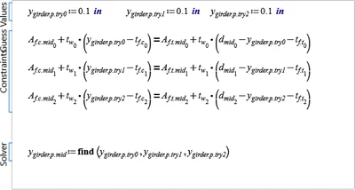

Hi, I noticed in the attached sheet that I couldn't integrate a function containing vector input. The same issue came up in my solve blocks trying to find a solution for an equation with vector input. I made a work around by splitting up the vector input in individual elements. Does anyone know a solution that doesn't involve splitting up the vector input? I have highlighted my questions in the attached sheet. Thank you!

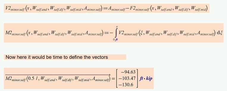

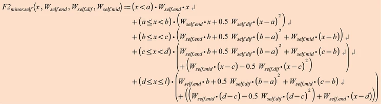

I did it with the functions necessary for the integral, starting with
and continuing with
Voilà!

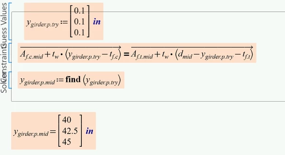

According the solve  block all that is needed is to provide a vector as a guess and vectorize both sides of your equation:

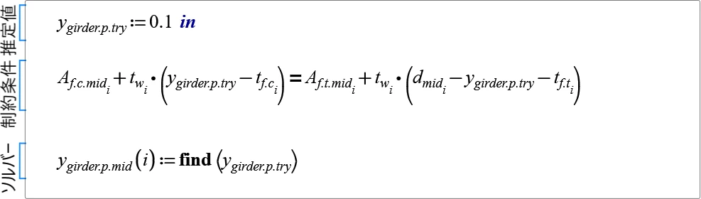

You cannot use elements of an array as arguments to the Find function in a solve block.
You can use multiple expressions in a solve block though:
with as result:
