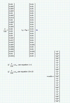

Hi all, can anyone teach me how to produce the results based on the if statement as shown in the attached picture? Thank you for your kind help:')

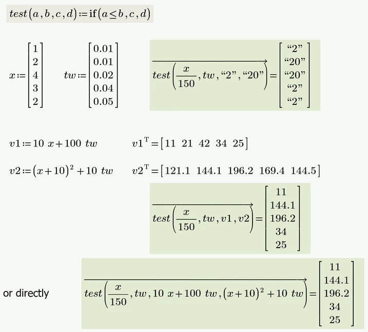

Simply add two additional arguments to Luc's function
23-Emerald V
Sep 18, 2024 12:56 PM UTC

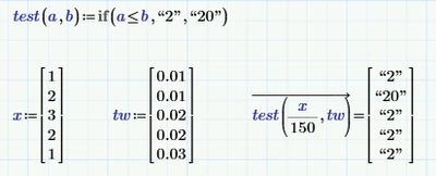

You have  just one problem: What should be the result if (x/150)=tw... (if they happen to be exactly equal)?
Anyway, here's your function, assuming equality should instruct to use equation 1+1:
Since you didn't attach the worksheet, and didn't state which version of Prime you're using here's an example:

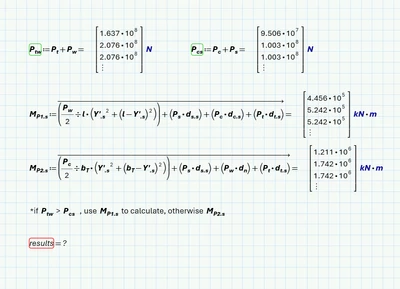

what if the value of 2 and 20 are in equation, not a single digit?
how can we produce a result following the if statement? example as below. btw, i'm using MathCad Prime 10.0.0.0
Werner_E25-Diamond IAnswer
Sep 18, 2024 8:08 PM UTC
