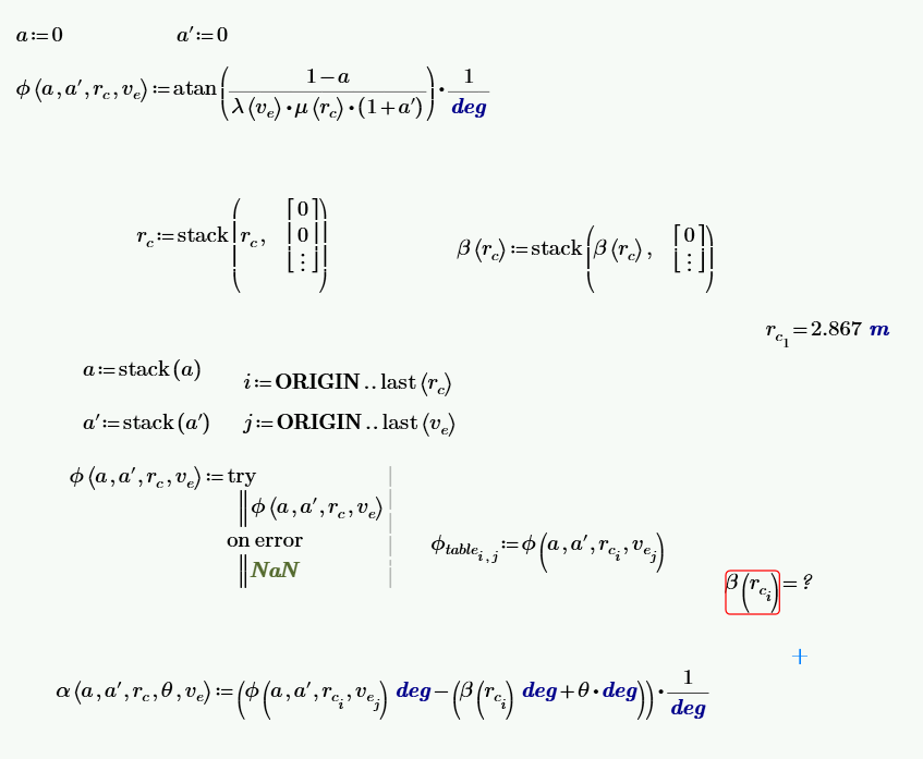

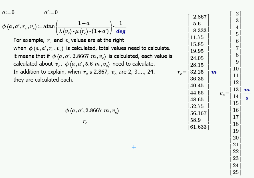

I got advice to use "vectorization"
But I wonder something.
I saw the book and I knew that "vectorization" is just possible to calculate about same raw and column.
But I need to know total calcuation values.
For example
a=0,1,2,3,4,5 b=1,2,3,4,5
y=ax*b
if I caculate by using "range variable", I get total calcualtion values. in case
<a=0,b=1> ,<a=0, b=2>.....<a=0,b=5>
<a=1,b=1>, <a=1, b=2>.....<a=1, b=5>
<a=5, b=1>, <a=5, b=2>......<a=5, b=5>
I want to get values following.
I couldn't have used "vector" because I thought that I couldn't get it.

I want to get values look like "range variable" because I need to total values when I did iteration calculation.
How to do what you want is explained in detail in the sheet I sent and various methods are provided for you to chose from. The function and vector variables used in the sheet are different from those given by you now because I used what you had provided in the last thread.
All methods given will calculate all combinations of values from the two vectors - the difference is the way those values are arranged. I also provided ways to arrange all values in a single column vector similar to what the result looks like when you use ranges, but I doubt that this data representation is the most useful. But if you really insist on it - its there.
I now can't attach my file because I need to clean my file.
So I try to explain what I want and why I do it
1. I need to calculate interation in case of changing variable such as a, a', r or mu.
Werner_E25-Diamond IAnswer

jlee-21-VisitorAuthor
Nov 19, 2014 1:56 PM UTC
I could success to express theta look like "range variable"
But I can't get "alpa"
I guess the reason why I can't get values is due to "beta"
I got error. error said me that the unit is not compatible.
so I don't know which it is wrong.
23-Emerald I
Nov 19, 2014 2:41 PM UTC
I'm beginning to believe that you are leading us on; you keep making the same errors, failing to grasp the same concepts.
Read the discussions in the help files about units, range variables, vectors, etc.; and built yourself little demosstration programs until you understand how this software works.
