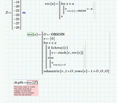

Hi everyone,
I need to change an array into vector in Prime 10 .
@StuartBruff ..Stuart you have previously suggested this method , but I don't know where I have a mistake
Can you show me how to solve this? Prime 10 is attached
Thanks in advance

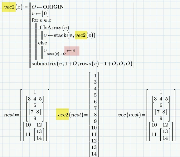

Nov 18, 2024 3:11 PM UTC

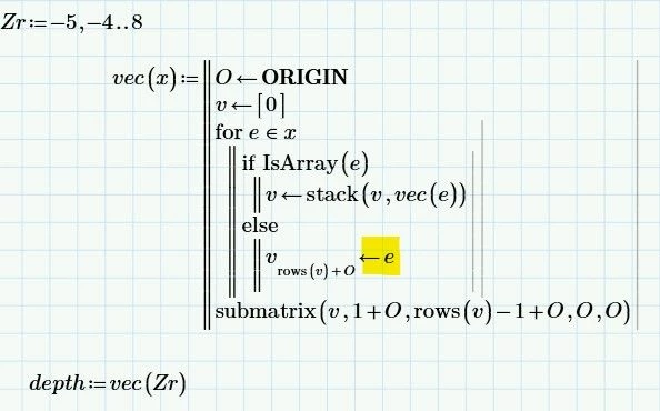

Terry already pointed you to the missing assignment.
But the first, simpler version of "vec" you show in your picture should work equally well!
Stuarts version has the benefit that it also unravels recursively nested vectors. But thats not necessary when you just want to turn a range into a vector. You also should not keep both versions of "vec" with the same name in your sheet. The call of "vec" in the "stack" function of the second "vec" variant would call the first variant and not itself as it should be. Thats the reason I renamed Stuarts function to "vec2" in the picture below which is just here to demonstrate what Stuarts function is capable of:
The simple "vec" is only good for turning a range into a vector.
Stuarts extended version will also deal with nested matrices.
It will not deal with matrices containing ranges, though 😉 😈
Dealing with this moloch, too, would make it necessary to add Stuarts "IsRange" function alongside the "IsArray".

terryhendicott
Nov 18, 2024 11:32 AM UTC
Z is already a vector not a range.
Cheers
Terry

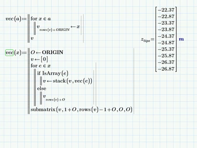

Nov 18, 2024 11:38 AM UTC
Hi Terry,
Thank you for replying .. actually this is the original sheet
and it tells me I need to have ztips as vector
the above sheet was a simplified sheet to explain what I need to do ..

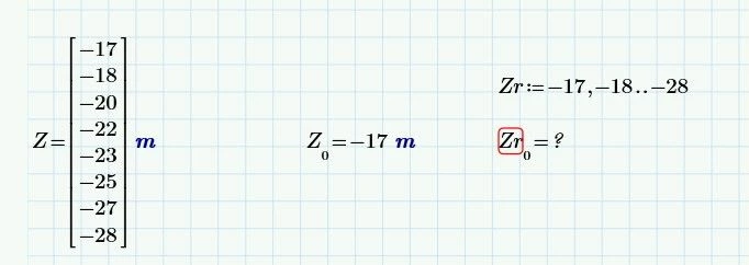

terryhendicott
Nov 18, 2024 1:17 PM UTC
