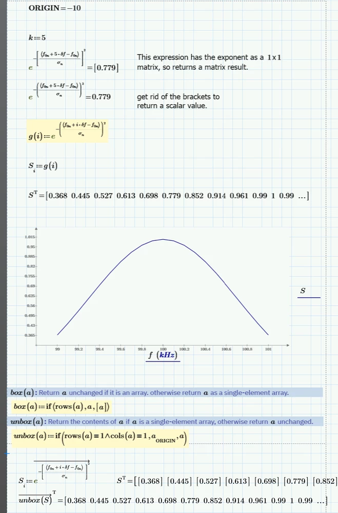

I am trying to fill a 1D array/vector with calculated scalar values. This works fine for a simple calculation; but for a more complicated calculation, it fills the vector with nested [1x1] arrays instead of scalars. I have tried to use Vectorize to fix this, but unsuccessfully.
As an example, I define an array index i = -mf::mf. A simple function f_sub_i = f0 + df*i works fine to set up a vector of frequencies f with uniform step size df. But now I try a Gaussian function S_sub_i = e^{-[(f_sub_i -f0)/sigma]^2} , and I get a vector of nested [1x1] arrays instead of scalars. How can I get a vector of scalar values calculated by the formula for S_sub_i?

Your exponent is a 1x1 matrix (or vector, depending upon your outlook).  Consequently, the result is a matrix.  Get rid of the bracket, and all is well.
Alternatively, I find the function unbox, and its counterpart box, to be helpful on several occasions

OMG, I’m so used to thinking that [brackets] are the same as (parentheses), just at a “higher level” of nesting. But of course you are right – brackets in MathCAD indicate an array, NOT like parentheses. Thank you so much!

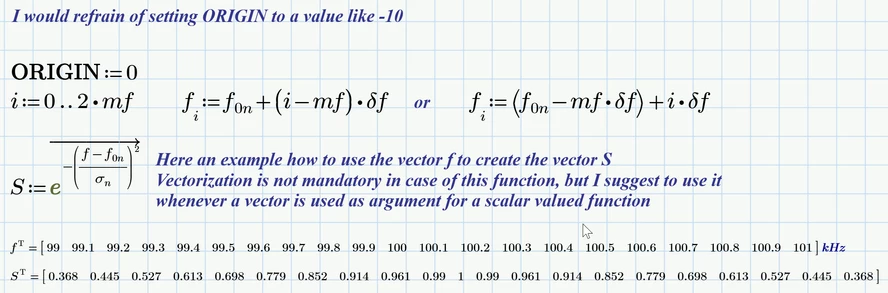

Stuart already explained the main problem: Don't type a square bracket unless you really want to create a matrix/vector.

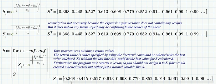

Here is your fixed  Prime 9 file attached
I would also suggest not to set the ORIGIN to an unusual value like -10 just to make it a little bit easier to create just one vector (f).
I also would suggest to use the vector f itself when creating the vector S. Vectorization may be done automatically in case of the expression you are using but may not with other expressions. So its a good idea to always explicitly apply vectorization whenever a vector is used as argument in a scalar function - just to be on the safe side.
