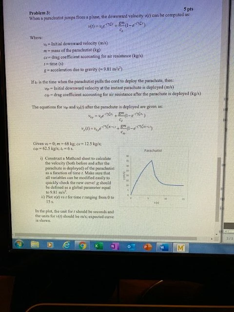

velocity program
Need help with creating this in mathcad

This not only appears to be homework, but it IS homework.
This means: You start by creating a sheet with formulae, data and a plot.
We're here to help if you run into specific problems with the use of Mathcad.
In that case:  Attach your worksheet (not just a picture) and be specific with regards to the problem(s) you are facing.
