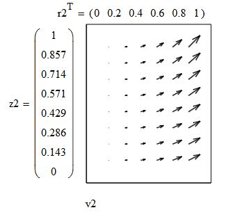

Hello everyone,
I am working in a fluid mechanics thesis(in mathcad) and I confront a problem with the visualisation of velocity field. The function of velocity depends on vaiables r,z (I've already found a set of values of r,z). I would like to inform me if it is possible how to depict the velocity as a vector in the same graph with the r,z.
Thank you!

For the lazy person, you can use the 3D vector field plot and just show the r and z vectors along the axes. This gives an approximation because the r and z values are not precisely aligned with the plot, but the trends are shown.
I reversed the r, z and v rows and columns to make r2, z2 and v2. Then, after making the plot and aligning the r2 and z2 vectors alongside the plot, I captured the group in a picture. This allowed me to expand the picture so everything remained in the original proportion.
For development work, this may be okay, but not for publication.

Thanks for your response..I searched about 3d vector field plot but I think that my version doesn't support it.
I'll check once more your method.

You wrote that you are using Mathcad 14, so your version supports vector field plots.
You may insert that graph via "Insert/Graph/Vector Field Plot".
If you have already inserted a "normal" 3D-graph (for instance a surface plot via ctrl-2), you can change the plot type in the 3-D plot Format menu (double clicking the graph) in tab "General".
