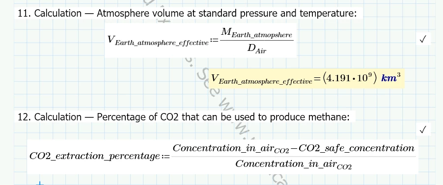

In an equation, the horizontal line between a numerator and a denominator is called the vinculum. In working my analysis using Mathcad Express V8, in some defined variables, the vinculum is greyed out while the rest is normalMathcad V8 vinculum greyed out.png.  Another defined variable right above it is normal. The font type, size, and color are both the same.

Does it print greyed out, or is that an artifact of the display graphics?
October 30, 2022
I have not yet tried to print.
October 30, 2022
I found that this is a zoom issue with mathcad.
October 30, 2022
What screen resolution do you have?
October 30, 2022
MIS laptop with 1920 x 1080 resolution. I have been working on this laptop for several months and this issue kept popping up. After posting the question, I changed the zoom and noticed that it disappeared for one variable and appeared for another. I was working at a zoom of about 115 percent.

OK, you found out yourself that this display glitch has to do with the (Prime) zoom factor set, and also windows zoom factor and screen resolution.
And Luc already noted that this bug is already known since very early Prime versions and obviously is still not fixed.
