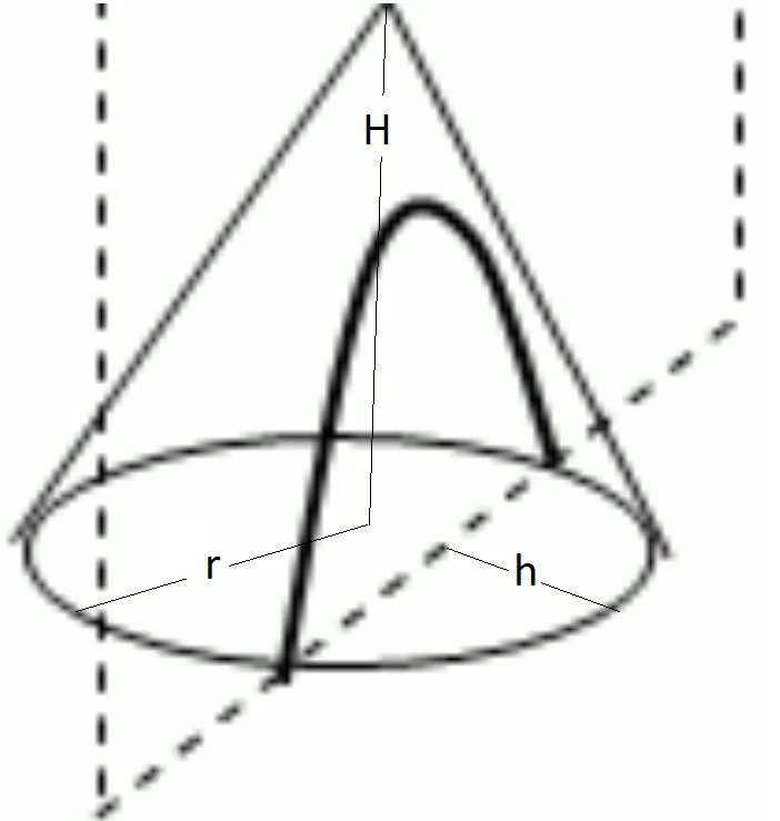

Sorry,
I cannot find the formula for a volume of a part of the right circle cone (a small part or a large one). The plane is vertical (one branch of hyperbola in the section). V(r, h, H) := ???

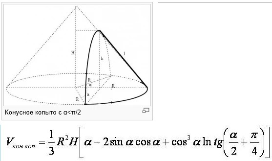

Утро вечера мудренее! it is a Cone hoof!
See cyclowiki.org

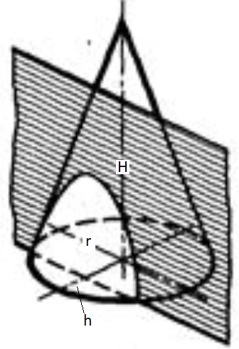

Thanks, Fred.
Today I have saw in my dream that a volume (of the part) of the cone is 1/3 of a volume (of the part) of the cylinder:
V(r, H, h) := ???V(r, H, h) := ???
