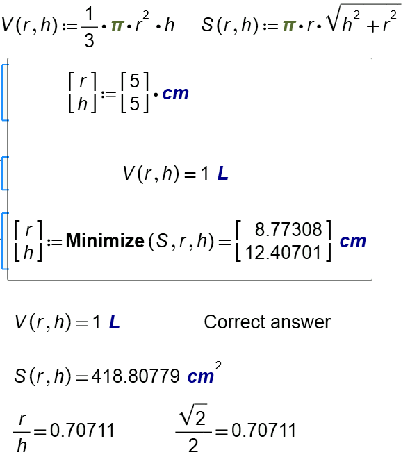

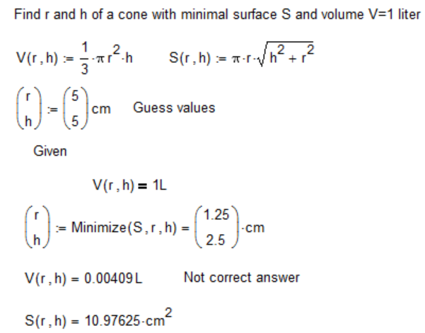

Perhaps it has long been known, and maybe something I do not understand, but I have encountered such a strange situation - Mathcad 15 is completely wrong working with dimensional quantities in a solving block.
Example - in the attached file.
The man from the image of this group.
All OK in Prime
While IMHO this would not justify downgrading from Magthcad 15 to Prime, the slightly better integration of units (think of odesolve) sure is one of  few benefits of Prime.
The effect itself is well known and its a matter of the CTOL-setting just working on default units (here meter).
We can help Mathcad 15 to give us the correct solution but admittedly Prime comes closer to the exact solution as you can see:

Hi Valery
The problem im Mathcad 15 is due to the default value of CTOL wich is 0.001. This value is equal to the right hand side of the constraint. Thus as soon as Mathcad finds values of r and h wich give a volume between 0 and 2 liters, iteration stops.
Regards
Ueli Rettenmund
