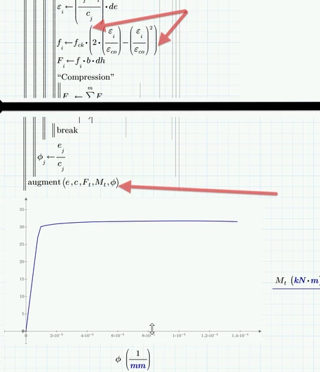

Two problems in your sheet:
1) in one place you used a square bracket instead of a pair of parentheses. Square brackets create a vector/matrix. Thats the reason Ft and Mt are vectors consisting of 1x1 matrices
2) At the end you should not return the calculated vectors by putting them into a 1x5 vector as this creates a nested vectors structure and you would have to use D[0,2 to get the vector Ft.
It seems to be cleaner to create just a big matrix using augment. That way you can access the vectors the same way you tried anyway.
Worksheet in Prime 5 format attached.

The output of your program ( D:=...  ) is a row-array containing vectors as elements.
You assign the first element to epsilon.0, and it becomes a vector (=column-array) of 1 element {due to the way you pick it out of D}. That one element is a vector with 31 elements. Had you assigned epsilon.0:=D[0,0 it would have become a simple vector.
You are trying to plot M.t, take as is the fourth element of D, and (again due to the way you picked it out of D) is a (1 element) vector, containing a 31-element vector, that contains one value of 0 and the remaining 30? elements are each 1-element vectors.
Your Phi has similar problems.
Mathcad  (and Prime is no better, nor worse than that) can ONLY plot vectors and scalars (not vectors containing vectors containing...).
You'll have to restructure your program, to assure that (ideally) D contains only 5 vectors, or that all data is contained in a single matrix.

Thank you very much Mr. Werner_E for your solution. It's working. I just know function of "Augment". Once again thank you very much.
September 21, 2018
You are welcome.
I think its a better and more versatile way for the function to return the row vector of result vectors as you did it in the first place instead of the matrix created by augment as I suggested.
Its quite easy to separate the five vectors as you can see in the picture and you even can omit the variable D completely if you write  [e c Ft Mt phi] in front of the program instead of D if you like.
