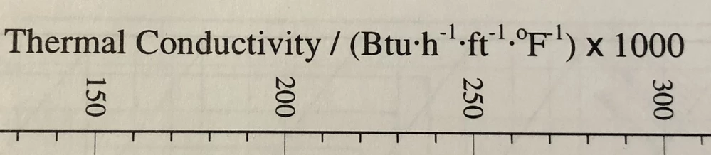

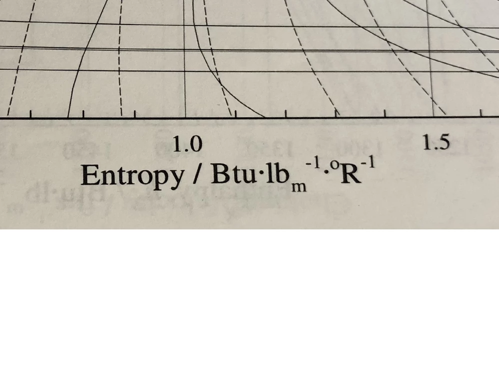

I have one gift from NIST - one paper reference book with properties of water and steam.
I have asked people in NIST why in the book the unit of entropy is Btu / lb / °R but the unit of thermal conductivity is Btu / hr /ft / °F (see please pics)
The answer was so:
It is much easier to change the US Constitution than to force American heat engineers to use Rankin's degree, rather than the Fahrenheit's degree in the heat conductivity unit!
The correct unit of thermal conductivity is (SI) W*m/m^2/K but we use the simplified form W/m/K
