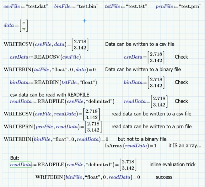

Hi Werner, thanks for confirming.
Just checked. Apparently it was fixed in Prime 5.
I am not sure if I need to do something, but only I opened your file in Mathcad Prime 9 and this is what I can see:

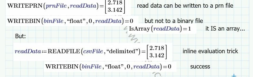

Hi Luc,
No error in Prime Express:
Cheers
Terry
I opened your file with Prime 4 and can confirm the bug.
It is already fixed in Prime 6 (I don't have P5 installed, so can't say if its already fixed there)

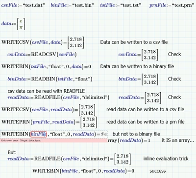

LucMeekes23-Emerald VAuthorAnswer
23-Emerald V
