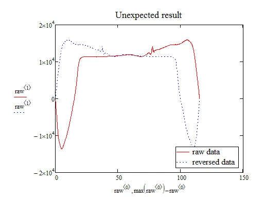

I do still have an unexpected result from the reverse function although it works as expected in some instances; see attached sheet.
When creating an array and reversing the order of the second column then one sees in the graph the reversed function. I.e. last values being depicted first.
However, when I do the same on some measurement data, all I get is the weird looking curve in the left graph.
Does anybody have an explanation? Mike perhaps?

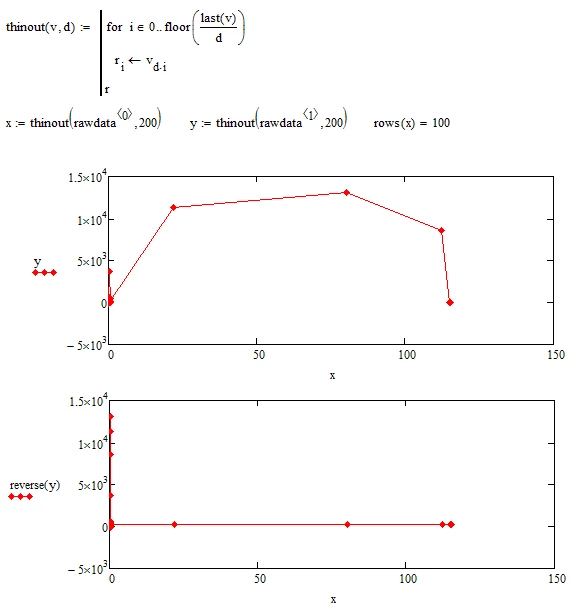

We can see the effect better if we thin out the data to, lets say just 100 data points.

It seems to me that your graphs are plotting from right to left?
When you reverse the data the extreme values of rawdata<1> correspond to smaller values of rawdata<0>. To me the results are what I would expect.

Sorry Mike, I mixed up the zip files. Here we go with a new one.
What I don't understand is why the graph of the reversed measurement points is not the mirror image of the raw data as shown in the right hand graph.

Raiko,
I also expected a mirrored graph at first until I realized that this woul only happen if the abscissa values are equally spaced as they are in your test plot to the right.
But they aren't in your measurement data.
Here is a plot with your data thinned out to 100 points only. You can clearly see that we have just about half a dozen higher ordinate values. These are stretched out to the right in the nonreversed plot but crashed together to the left in the reversed one.
To get a mirrored plot you can either manually reverse the limits on the abscissa axis as Mike had done or you create a new vector for the absicissa with 150-data<0> where 150 is the maximum of data<0>.

Are you looking for something like this?
Mike,
you don't change anything if you reverse both vectors.
You have changed the limits on the absicissa manually and if you do that in the original plot you get the same efect 😉

Oops yes. The graphs are working correctly IMO.
I agree with Mike - its all OK.
The puzzling effect occurs because the values on the abscissa are not equally spaced.
If you reverse one of the columns, the higher ordinate values get related to very narrow spaced abscissa values which looks like a spike.
