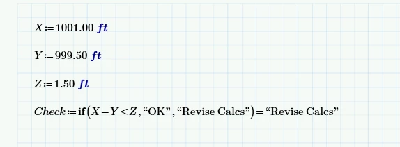

Hello All,
I am using Mathcad Prime 4.0. As seen in the photo below, I am just trying to use a simple if statement. I am wondering what I am doing wrong? The answer I should be receiving in my check is "OK" . Any suggestions?

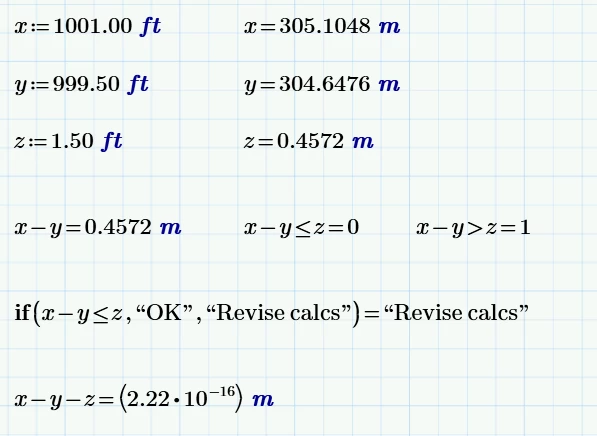

Your running into an accuracy issue. Bear in mind that:
- all united values are ALWAYS internally converted into SI units.
- there is ALWAYS a finite accuracy when dealing with numerics.
Here goes:
So the difference between x-y and z is just above 0.
When comparing numerical data, allow for some tolerance.
