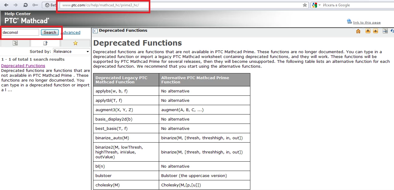

October 5, 2015
Alternative Mathcad Prime functions is used ( http://www.ptc.com/cs/help/mathcad_hc/prime3_hc/index.jspx?id=deprecated_functions&action=show 😞
  • convolve(vx, vy, [t], [s])
  • deconvolve(vz, vx)
Online Mathcad Prime 3.1 help center available here: http://www.ptc.com/cs/help/mathcad_hc/prime3_hc/
October 5, 2015
I bet it's the same function though, just with a name change.
October 5, 2015
Yes, it is.
