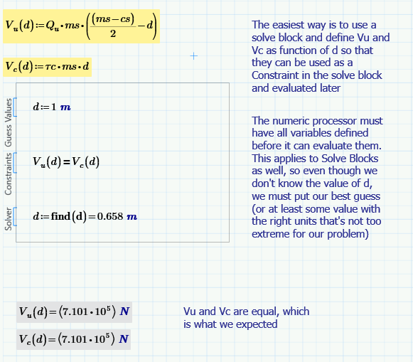

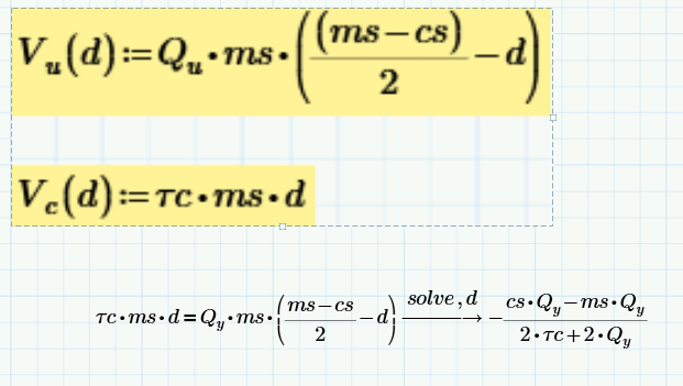

what are the steps we need to follow to solve this problem?
plese give me the steps and attech your solved file

Madesh,
This seems to be Mathcad related problem. Moving this post to Mathcad.
23-Emerald I
This is Prime 3.1.
Earlier version users cannot open this file.
