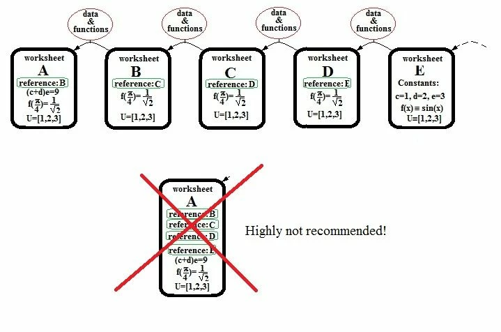

If you use MC15, referring to the "reference" you must follow the following structure:

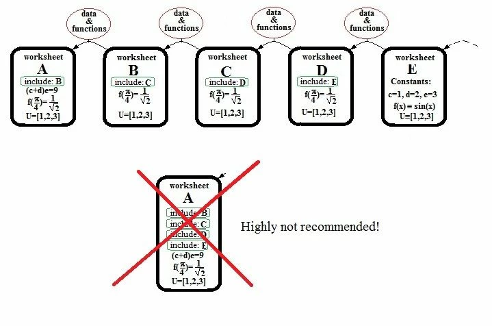

If, instead, you use "PRIME-4", you should observe the following rules:

As long as worksheet B does not include worksheet C, there's no problem to include both worksheet B and worksheet C into worksheet. Extend this strategy when worksheet C includes worksheet D... etc.
Bottom line: when building a structure of worksheets intended for inclusion, be sure that upon usage (actual inclusion) every worksheet is only included once (so either included directly, or included indirectly, not both at the same time.)
