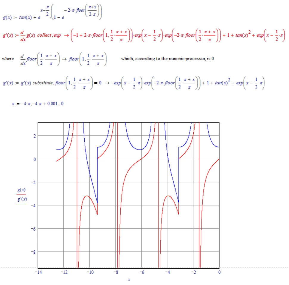

What expression does the "blue"-graph represent for ?
Hello Everyone.
From :
I.PNGWhat expression does the "blue"-graph represent for ?
Thanks in advance.
Best Regards.
Werner_EAnswer
November 6, 2018
Use a numerical solution with either "root" or a solve block, as we had it here already so often

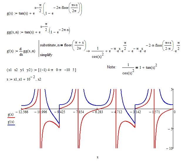

Luc is using Mathcad 11 with Maple as symbolics engine.
His sheet does not work for Mathcad 15 with muPad
Here is a workaround.
After all we don't need the exact derivative of the floor-expression (step function) which is all zero but with Dirac spikes at the odd multiples of pi. So substituting it with a constant does the job in MC15

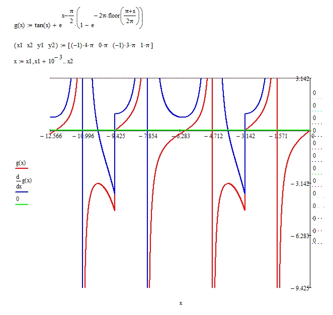

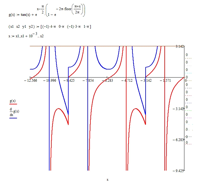

Plotting the local maximum-points of the 'red' ?
II.PNGRegards.
Werner_E25-Diamond IAnswer
November 6, 2018

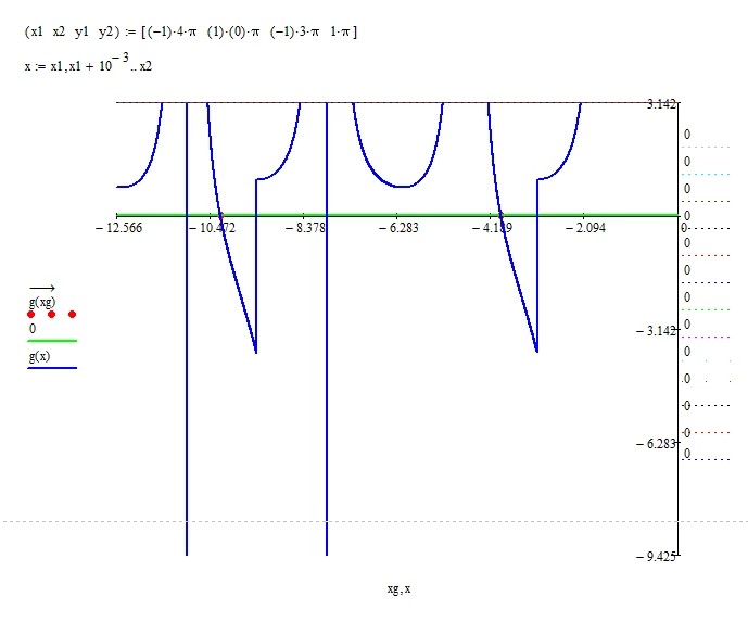

20-Turquoise
November 6, 2018
Adding -2*pi to the one old root ( the old 'red' point ) to get another new root ( another new 'red' point (backward to the left) )  is correct or not ? ( yes or no for periodic property ?)
