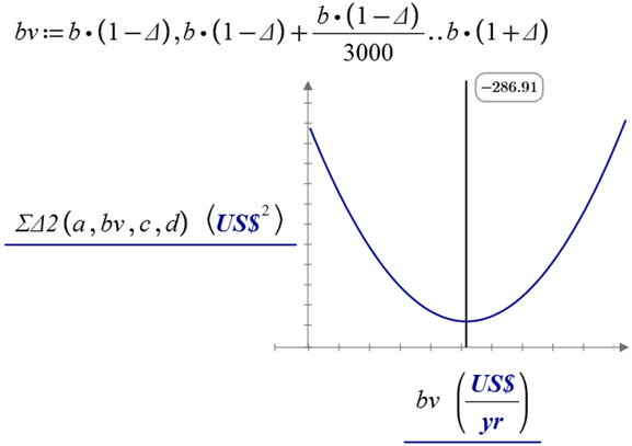

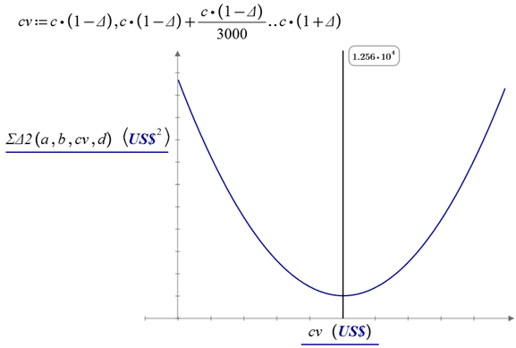

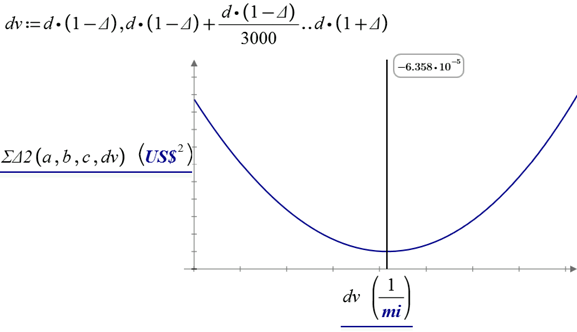

I have find the minimum of one function on 4 arguments and would like to check it by help of 4 plots.
I have done so:
