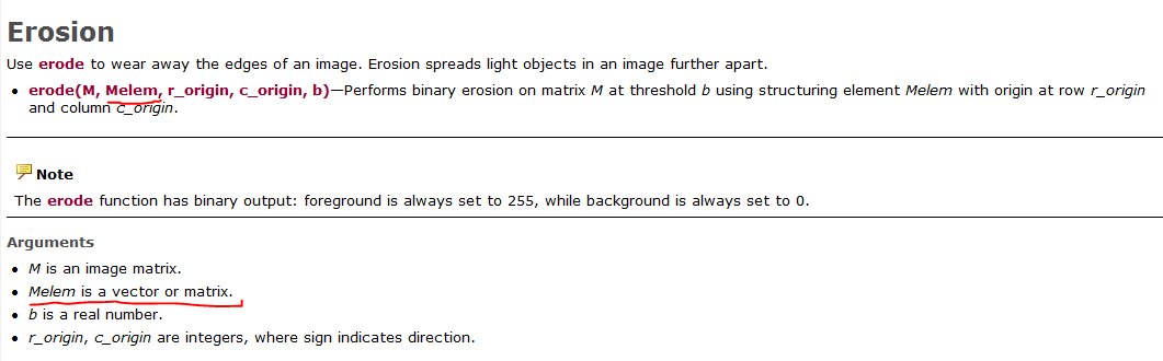

What is "melem" in the image processing functions?
I am very new to the image processing functions in Mathcad prime or Mathcad 15.0.  In the image processing functions, I don't know what "melem" does.  When I look in the help files, it says that "melem" is a vector or matrix.  I can get my functions to work with a basic matrix but I really don't understand its purpose or function.  Does anyone else know?

I should have been more specific.  Inside some of the image processing functions, one of the inputs is "melem".  This is about all the information I have found for what it is and does.
April 4, 2016
There are exactly four function using this argument: close, dilate, erode, open (and their counterparts gray_close, gray_dilate, etc.).
I am not well versed in image processing so I can't help determining the exact meaning of that "structuring element". As far as I understood at first glance Melem influences what "neighborhood" means, but I my be wrong about that. Why do you think that you need those arguments?
Admittedly the documentation is less than mediocre in that respect. I could not find more information than in the Image Processing E-Book (Mathcad 15) under "Morphological Processing" where some examples with a vector and a matrix  Melem are given.
