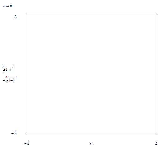

What is the better function for this curve?
The data in attach (Prime 5)!
Thanks!

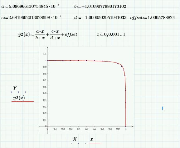

Using zunzun.com it returns this as its best answer:
15 replies

And, of course, no solution without an animation:
23-Emerald I
March 2, 2020
Thanks!
Mathcad Prime <6 please!

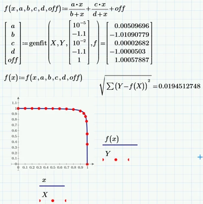

March 2, 2020
You may create suitable values using "genfit"
