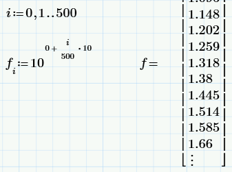

What is the difference between Prime and Machcad 15, because the function works in 15, but in Prime does not work.

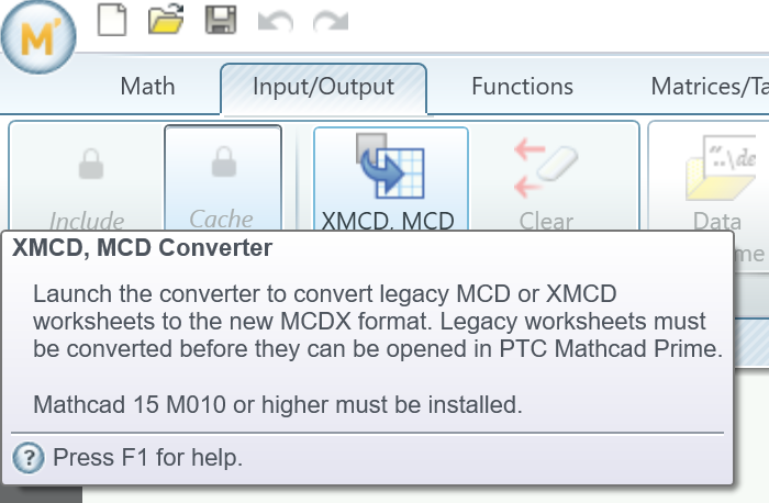

Prime can convert Mathcad 15 files, but not read them. See the input/output tab. You need to have Mathcad 15 installed, and the converted worksheet may not work, and may need editing.

You must use the convertor in Prime to convert xmcd into mcdx format.

Looks like you used a literal subscript (Ctl+-) where you should have used a matrix index ([) for fi.
Note the difference between the two in the following example:
The literal subscript returns the error shown.
Visually, the matrix index is lower than the literal subscript.
