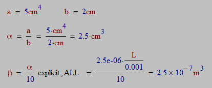

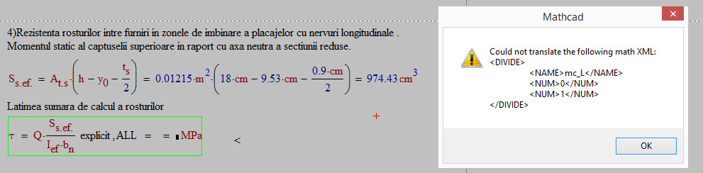

What is the problem? explicit function
his appeared only i use explicit,

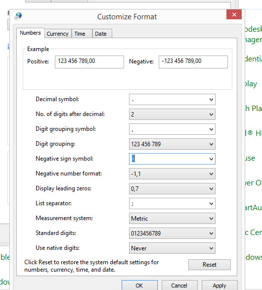

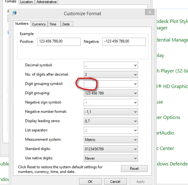

Thanks very much for help! I resolved it with change in Regional settings "Digit grouping symbol". It is a bag in the Windows 8.1, when select in Region: Russia, in place of digit grouping symbol is simple space.
when i change this in this form:
everything worked as it should!!!

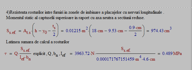

on the page 7

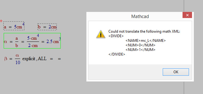

I'm use Mathcad 15 (M045).
It's problem appear everywhere. for example most simple:

No error for me (MC15_M010):
I'd suggest reinstalling Mathcad.
