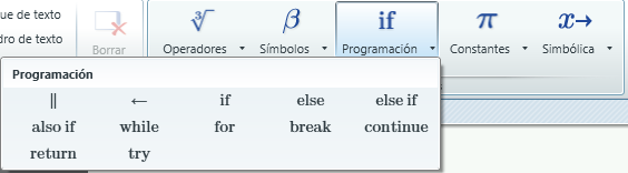

I have some experience in C language, and I know the structured programming, and in the structured programming there are no the "functions": break and continue as there are in MathCad programming.
In Mathcad the programing paradigm is object oriented, declarative or another?

Mathcad is a mix of declarative and functional.  Functions are (almost) first class objects and can be passes as arguments and returned from programs / functions.   With the addition of a few simple functions to cater for implicit loops, I can often write a worksheet in a functional form that transfers well to, for example, Haskell.
I suggested object-oriented as an extension about a decade ago (my, how tempus has fugited!).

C has both break and continue statements, and they do the same things as the break and continue statements in Mathcad.
Trying to compare C to Mathcad is kind of like trying to compare a fish to a dog. They are so far apart that it probably doesn't make much sense. If you do want to make such a comparison, then in addition to what Stuart has said Mathcad worksheets can also include things that are best thought of as objects (such as graphs and controls). I certainly wouldn't call it "object oriented" though.
Perhaps we could give you a better answer if we knew the reason behind your question.

The C language has statements "break" and "continue" of course the C language, but they are not accepted by the structured programming, the book "C how to program" of Deitel and other say it.
My question is motivated to find a language with the same paradigm of Mathcad programing (or at least the same statements) and practice because I have not found much information programming in Mathcad.

Look up the "Help" in the "Resources" tab and open the help book on "Programs". There you will find information on programming and some examples.
There's also a "Programming Tutorial" in the "Tutorials" book in the "Help".
