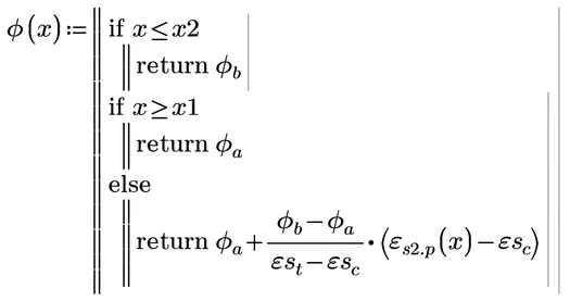

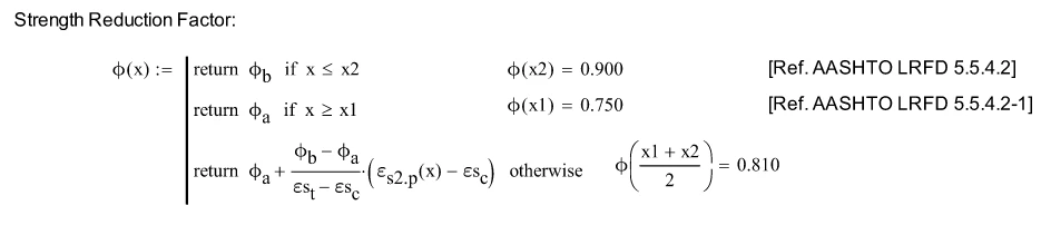

I'm following the attached example design, but I can't tell what function/tool in Mathcad they're using. I understand the purpose of the section and what values it should return, I'm just not sure how to make Mathcad do it. It kind of looks like a programming block, but it doesn't have the bar on the right and it isn't formatted the same inside. What's tripping me up is that the value if "x" isn't constant, it's variable so I can't use simple if/else programming. I only have the file in PDF format.
Yes, you are right - its a programming block. but its made with real Mathcad, a version prior to Prime (maybe Mathcad 15 or older). Thats the reason a programming block looks differently.
There is only a single vertical line indicating a programing block, if there is only one command in an "if", the if-statement is condensed to just one line instead of spreading over two and instead of "else" the older Mathcad versions used "otherwise".
In Prime it would look like this:

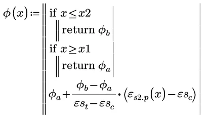

And because the else branch is the last statement in the program, you can omit the "else" and also the last "return":#

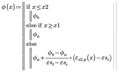

And using "elseif" you could do it without any explicit "return" statement
??? Not sure what you mean?
It is a function that returns one of three values depending on whether x is less than x2, greater than x1 (obviously x1>x2) or between x2 and x1.
Only if x2 < x < x1  a value dependent on x is returned, otherwise constant values phi.a resp. phi.b
