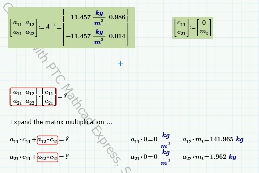

LucMeekesAnswer
23-Emerald V
The Unitless 0 in C does not match with the volume that the matrix multiplication gives.
If you set 0 to m^3, or like I did, multiply it with any defined volume, you get your result.
23-Emerald V
When in doubt, expand matrices, ...
Stuart
LucMeekes23-Emerald VAnswer
23-Emerald V
