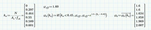

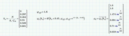

What is wrong with the script? Two identical scrips but two different outputs
Hi
I have two identical scripts with identical input data. However, the output vectors differ. What is wrong with the second one??
Thanks in advance!

The 'scripts' are not identical, apart from the definition of phi.eff (1.6 versus 1.60):
The first one uses e, the base of the natural logarithm in the expression for phi.k.
The second one uses a variable e, the value of which probably has a unit of metres m.

Don't use a variable name the same as a function name,
Cheers

Nov 13, 2024 10:47 AM UTC
Thank you so much! The e-base solved the problem 🙂
