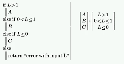

When using IF statements in Prime, start by typing "if" in a math field, then ctrl+J to activate it. On the next line, type elseif then ctrl+J, then as many more elseifs as you want, and end by typing "else" then ctrl+J. I believe that your "otherwise" would be called "else".
Similarly, you can use a vector of logical statements to choose your outcome. This is great if you're using Express, but otherwise the if statements are more readable and give you the option of error proofing your inputs. Best practice is to include all logical options in your if and elsifs, then save the "else" for the condition that your logical condition may be something you don't expect. See below for an example. I hope this helps!
