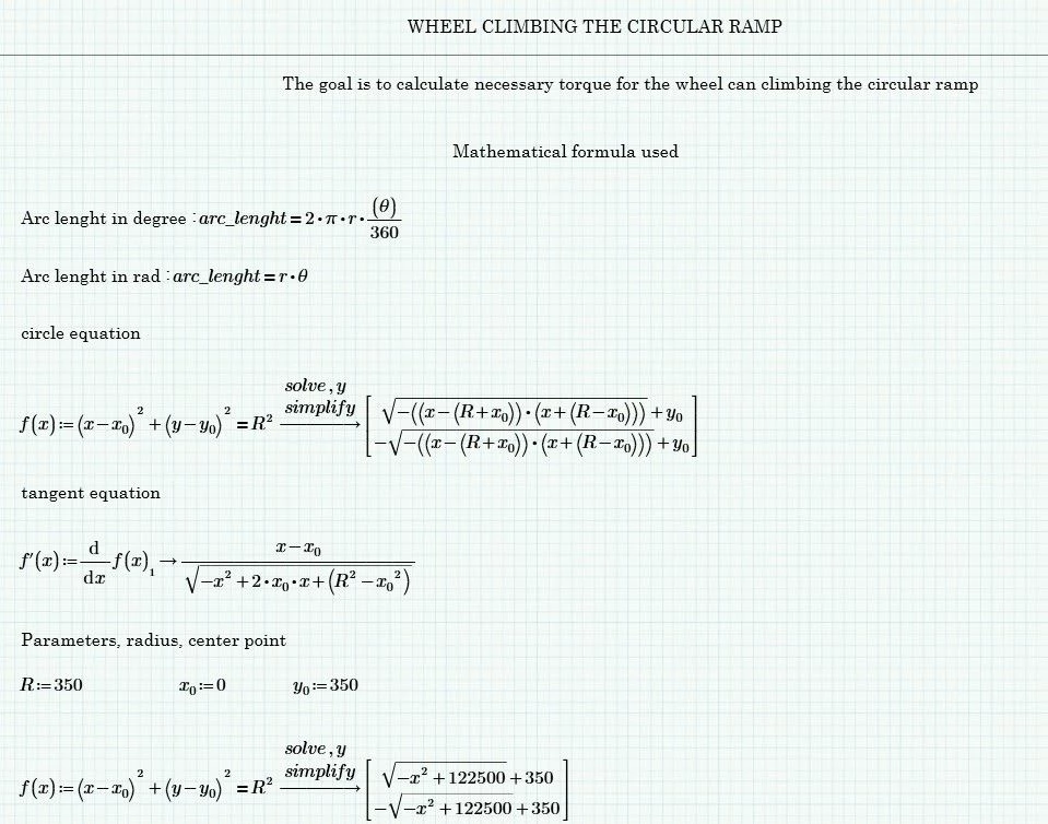

I want to calculate the wheel torque necessary for climbing a circular ramp.
I can calculate this, but it's not elegant and heavy, because i don't use mathcad programation correctly.
first:

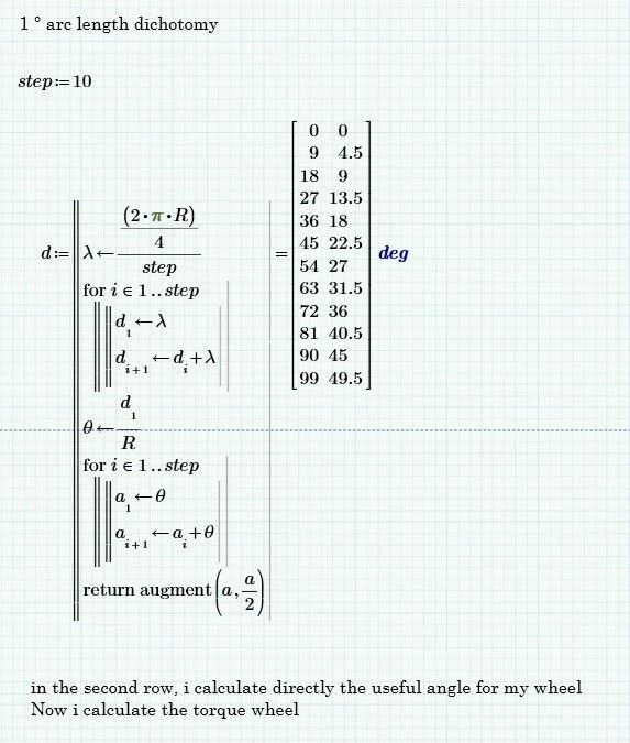

in second time, i dicotomize the arc lenght with step parameter

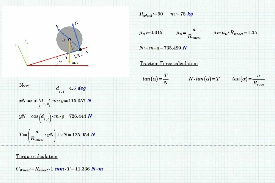

 Now, this is a mechanical problem, i assume the wheel goes up the slope.
The slope is the tangent equation at the coordinates point (from dicotomize function)
And the slope angle is simply a/2
 i think the result is OK
But i want more 😁
I want calculate all traction forces T and all torque C  for all dicotomized value in a (one ?) program.
and after draw the result 🙄
and i'm lost to do this🤔

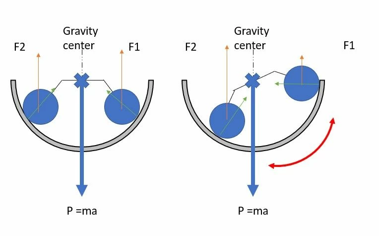

In the second step (after) : i have 2 drive wheels, the P force( f=ma) are apply in center line who link 2 wheels
i want to calculate Normal Force (N) variation. Because, the wheel climbing ramp, the normal force are modify by gravity.
obsiouvly the torque will also vary
and finally, the ultimate goal is find a critical position where the Torque is max
(taking into account the variation in Normal force(mass and gravity) and angle)
