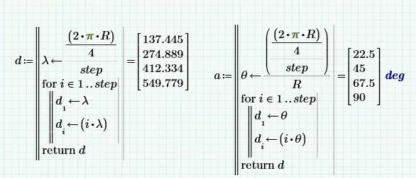

I need to calculate a drive torque for a wheel climbing a ramp.
i can calculate this,  but my worksheet is not elegant and is heavy 😥 (probably, i'a m using matchad programmation not correctly)
Here is now i do
The ramp is cylindrical profil

now, i dicotomize a ramp ( arc lenght)

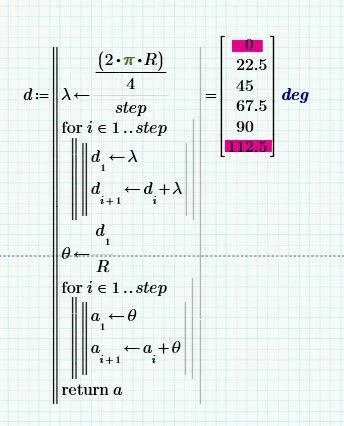

In second time. At this step, this is a mechanical problem
I assume the ramp angle is simply a/2 .
In fact, the ramp (red line, on the picture) is the tangent equation at the circle. the first point where we calculate a tangent is calculate with polar coordinates from dicotomized values.

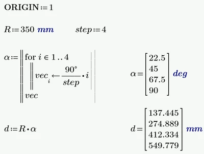

The maximum is not exactly at 22.5°:
Good thing that we have functions 🙂

I wrote a nonsense😓
a/2 🤒  just a is ok
but how to do exit red value

sorry i make a lot of rookie mistakes
 good
July 23, 2020
Why is your radius R unitless?
