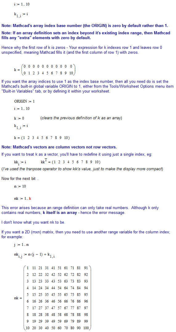

Sorry. I made a mistake in my query. I would like to create two range variables (not arrays) the second one using the first one.
k = 1..10
n = 10
j = 1..(n-2).k
When I try evaluate j I get the error message that k needs to be real.

You are right when you say that your array k consists only of real numbers and Mathcad is correct when it moans about k not being a real number. k is NOT a real number, k is an array, a  2 x 5 matrix.

You can't make a range variable that uses another range variable.  You could write   j := 1 . . 80,  (10-2)*10
