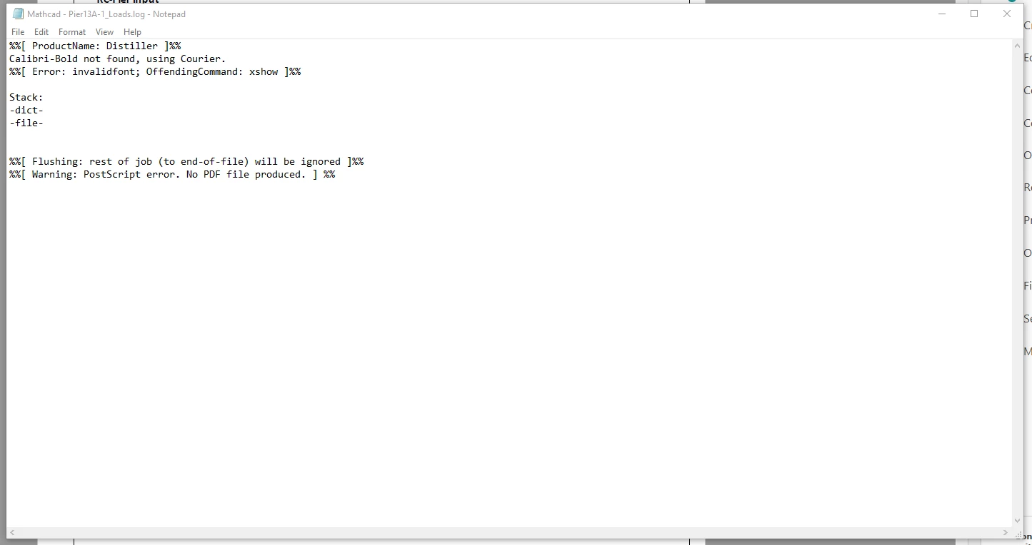

when printing Mathcad docs to PDF, they print as text msg instead
when printing Mathcad docs to PDF, they print as text error instead.  We are using output from Mathcad 15 ver 50 to print PDF's using Adobe DC Reader. They are being converted to text error msg. See attachment. Has anybody seen this

I guess the message is clear. Adobe doesn't know the Calibri font, and possibly another font that it can't substitute.

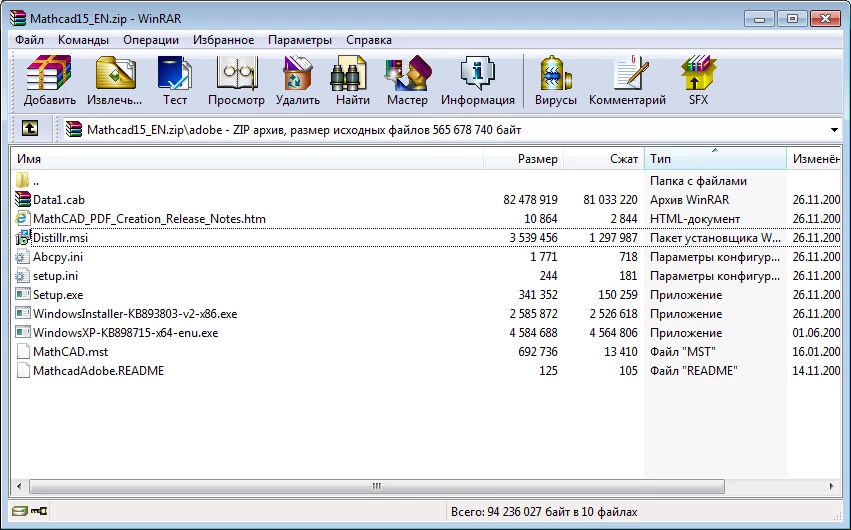

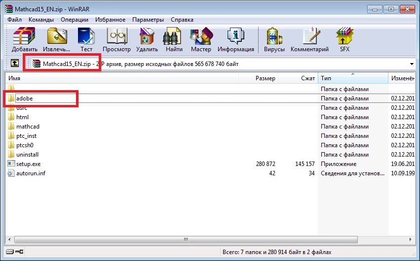

Try to reinstall "Mathcad PDSi viewable support" component (by Adobe Systems) from your Mathcad package.
