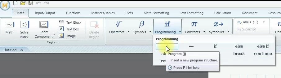

Where is the command addline?
Hi
I need use command addline.
I don't see the command addline in the PTC Mathcad Prime 9.0.0.0
I had seen this command in previous versions of this program, but not now
please guide me.

Iraj5-Regular MemberAuthor
Oct 6, 2023 9:12 AM UTC
Hi
i see this command.
i try it.
But this command does not have the function of addline command.

@Iraj wrote:
Hi
please guide me.
Previous versions of Prime or are you talking about real Mathcad (Mathcad 15 and below)?
In Prime once you created a program structure you simply type "Enter" to add a new line of program code!
