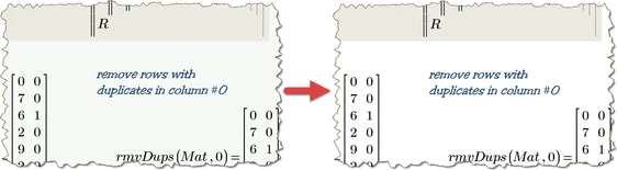

When you select just one math region and copy&paste  it, it will be pasted with a pure white background!
Unfortunately copy and paste won't work with multiple regions at once because copy&paste was severely broken in Prime starting from its first version.
You may consider using a program like SnagIt to do the screenshots. This program offers rudimentary image processing options and would allow to replace one color (the off-white)  for another one (pure white).
Still an extra step but sure more convenient and also better in quality compared to printing the worksheet and scanning the printout or printing to RTF/PDF and making the screenshot from the display of the appropriate program (Word/Adobe Reader).
