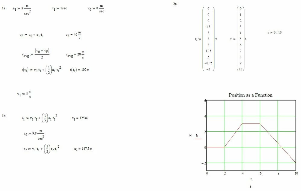

I have values for position and values for time. But when I try to plot them I get the error "All evaluations resulted either an error or a complex result". Can someone please help? this is very confusing!

You need to put t where you have 0..10 in the horizontal axis place holder!

if you are trying to plot the vectors x & t and it seems to work !
