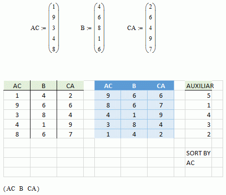

I am uploading an example where i created an excel table with component and added 3 vectors as input. If i arrange the number it works fine but when i press the mouse somewhere else to go out of the excel format it mixes again the numbers

You can't use tables nor ranges for sort the inputs values, but can use some combination of excel functions for sort, but in other place, not where excel get's mathcad values.

In case thats irritating you: You can't change the cells which are assigned by the three input vectors as the excel table will always be assigned their values upon recalculation.
I have uploaded the file. You can see an arrow in the begining of each line. If i sort the values on the table  from the smallest it changes all the places fine. But when i press out of the excel sheet(to go out of excel
editing.. Dont know how to call it) it brings back the numbers in the same order.
Sorry for the confusion. Hope it is better explained now.
For what Excel? Sort them in Mathcad!

But in this case if you change matrix AC you need to change manually also "Auxiliary" numbers?
