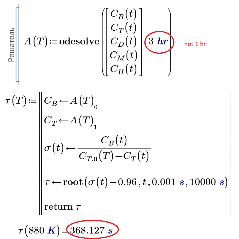

Why does a change in the time span change the value of the results of this ODEs?
Hello everyone,
How is it possible that by changing the time of my ODE system, also the result change?
I will link the program so that you can see what I am trying to say.
P.S. I use Mathcad Prime 3.1

Sorry, but 10 000 s > 1hr
