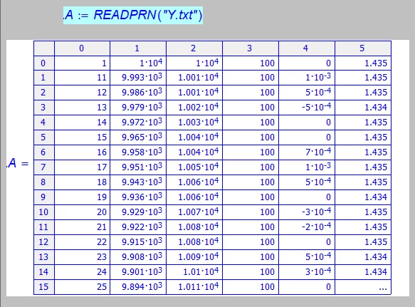

There are many examples of how to correctly read a text file, example.Screenshot_1.png

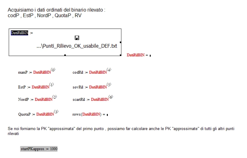

ccattaneo4-ParticipantAuthor
Feb 28, 2026 8:11 PM UTC
Dear 11-Garnet , thank you for the suggestion .
However , the READPRN function only imports .txt files that contain exclusively numbers, while my file (
Punti_Rilievo_OK_usabile_DEF.txt ) contains alphanumeric elements ...
I think I need to buy a laptop with Windows 10 Pro 64 bits installed and ask PTC to transfer my Mathcad 15 M50 license to the new hardware .

Have you tried re-specifying the path to the text file?
Feb 28, 2026 8:21 PM UTC
Vladimir N, certainly , but unfortunately the problem persists . If I had imagined this "big problem" I wouldn't have upgraded to Windows 11 Pro 64 bits - version 25H2 ( about nine months ago ) .
In my opinion , PTC didn't behave properly ; they should have at least adapted Mathcad15 M50 to be compatible with Windows 11 Pro 64 bites .
There are dozens of people who have been abandoned ... and they have a wealth of hundreds of files written with Mathcad .
Furthermore , PTC does not guarantee that the conversion of .xmcd files into the new Mathprime format will be 100% successful ...
