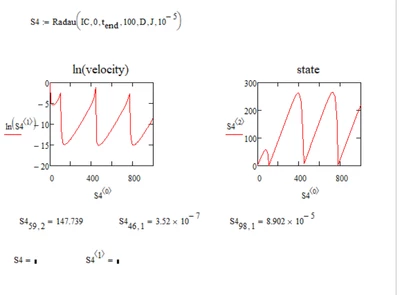

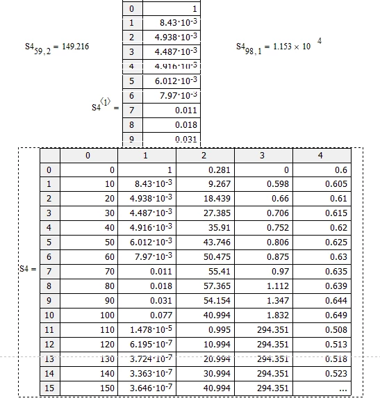

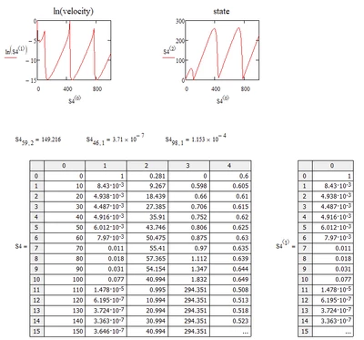

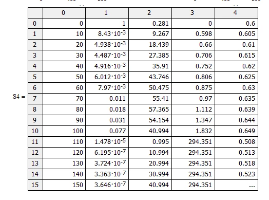

Opened the file in Mathcad 15 and the arrays do display (needed to rearrange and separate the regions):
As you also have troubles with the 2D-plots it looks like a broken installation.
Are you able to display other arrays? Can you display a small matrix which normally would display as matrix in table view?
Have you tried to install Mathcad on a fresh new system (e.g. in a virtual machine). Don't forget about the preliminaries which Luc already posted in the other thread of yours.
I don't really think that it will help, but I resaved the file (MC11 format) and attached it here. Just give it a try.
P.S.: I just noticed that the values blow the plots and above the tables are different compared to your screenshot!? Probably you had changed some input values before posting the file.

Hi Werner,
Thanks for taking a look.
I tried a small array as you suggest. It displayed in matrix format but not as a table. It does seem that I have a faulty installation.  I did successfully re-install MC 14 on Windows 10 a while ago when I had to replace my computer. Not sure what went wrong this time but I will try re-installing again taking account of Luc's suggestions.
I tried the MC 11 version that you re-saved but got the same result.
Not sure about the slightly different values. I  do not remember changing anything but I could have. When I run the MC 11 worksheet you sent, I get the same values as in the screenshot (and in MC 14). Could MC 15 be giving  slightly different results?
Happy Holidays!
December 24, 2021
It is be possible that they made changes in the algorithm used in the Radau function which then is responsible for the difference in the values but I am nor sure about that and I could not find any mention of a a change in the Radau function in the release notes of MC15.
I see that Stuarts screenshot shows the same values as I see - obviously he is using MC15, too and not MC14. I don't have an instance of MC14 installed so I can't give it a try.
But the main problem still remains the problem with your MC14 installation. I guess you are not under maintenance and so contacting PTC support may not be an option.

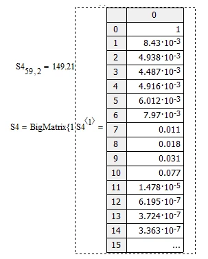

@JohnRudnicki wrote:
Just some additional images to Werner's:
Worksheet before S4 evaluation is complete:
S4 brought to the front:
S4 evaluation dragged down a few lines:
S4 display changed from Automatic to Matrix:
Stuart
