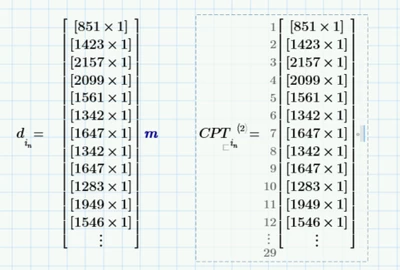

Is it possible to multiple MPa with the general CPT not only one matric (CPT2) .. they are 29 and it won't be effecient to do them one by one

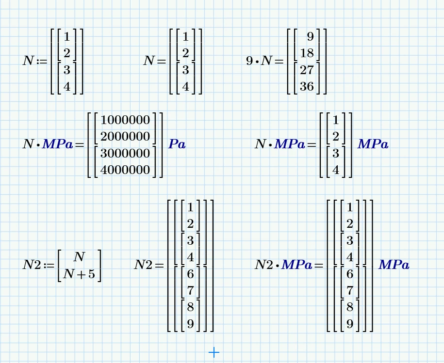

Try multiplying CPT by MPa.   Multiplication by a scalar seems to operate over a nested array.
