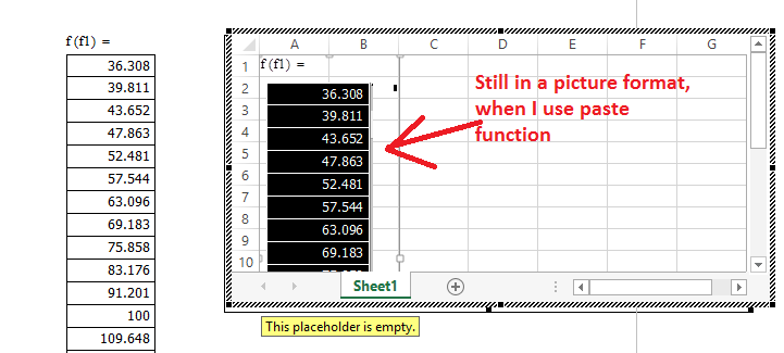

It seems like this method cannot work either. See this picture. I was trying to copy the data from f(f1) but it still shows in an imagine format, in the EXCEL component in my Mathcad worksheet.

Maybe the free version won't allow you to cache a worksheet.
