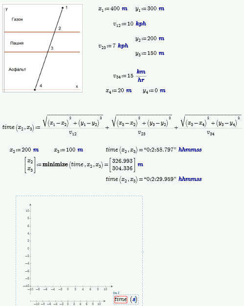

Hi Valery.
But whith createmesh you have the option to make explicit the units for the arguments of the function to plot, and don't need to destroy the units in the calculations.
Best regards.
Alvaro.

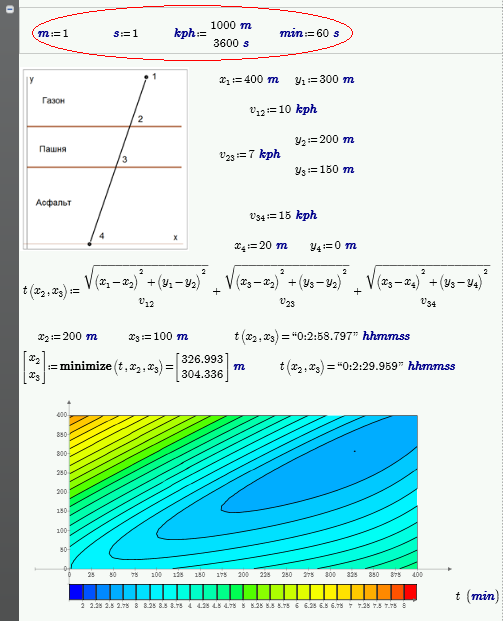

Hi Valery.
I guess that because Mathcad don't know which units have the arguments of the time function. Actually, the error message is the same if you call time(1, 2) instead time(1 m, 2 m).
Best regards.
Alvaro.
Thans, Alvaro, for the answer.
I think we must do so. Only so - it is the question!
