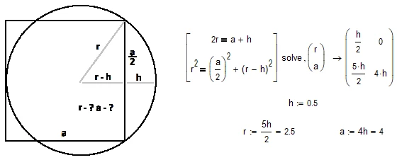

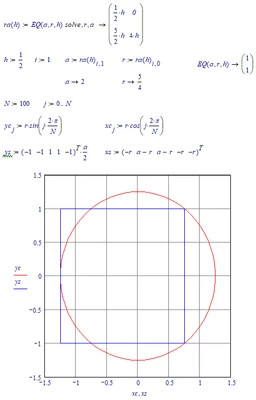

For some reason you have Mathcad in the position where it interprets 5h as 05h (that is 5, hexadecimal, equals 5 decimal). The same for a, it is 4h=4.
Because with h=1/2, you can have either:
a=2 and r=1.25,
OR
a=0 and r=1/4.
Which only plots the circle, as the square has sides of zero, and sits on -1/4,0.
a=2 and r=1.25,
OR
a=0 and r=1/4.

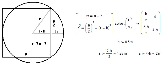

June 9, 2021
Thanks, Luk!
It was one error from one my student. And I have showed him how we can work with PTC community.
1 Use units of length in geometry problems.
2 Use dot here: 3*h, a*(h-1m) etc.
