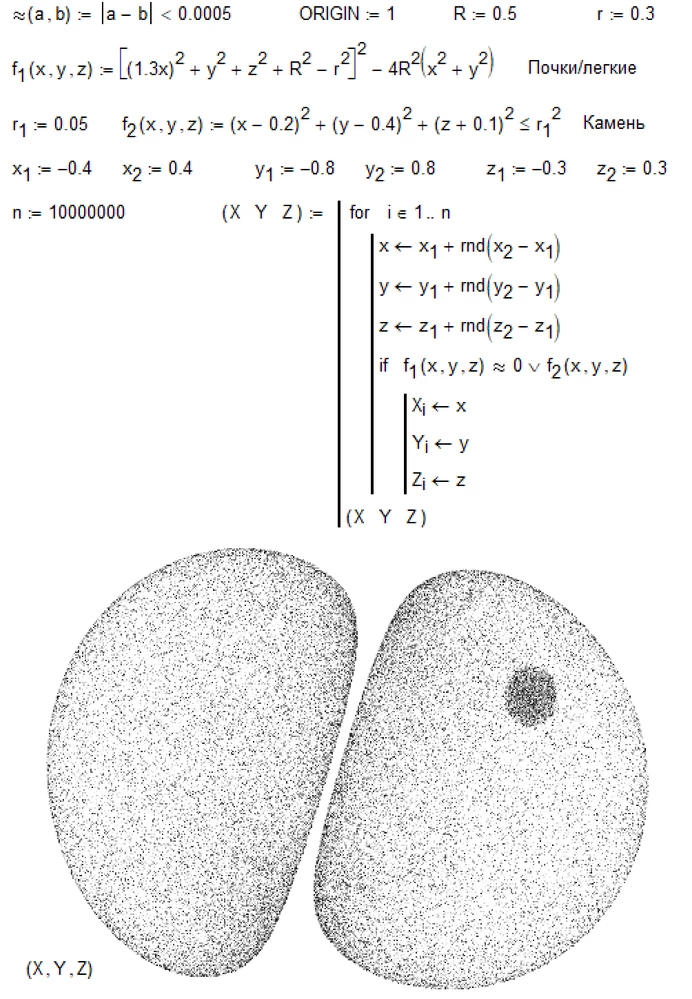

Why I have not vectors X, Y and Z with random numers?
I would like to get vectors X, Y and Z with random numbers?
But a random numbers is only in last elements.
Why?
See please the attach with archived Mathcad 15 sheet!
Thanks one more
terryhendicott
Subtle change in the definition of double tilde function to NOT at the top of the page fills your vectors with numbers rather than zeroes.
Regards
Terry
Thanks, Terry!
I myself see my error - not f1 and f1 but f1 and f2 must be!
Sorry
Val
terryhendicott
Hi Valery
I think I changed it to f1 in my mewssing with the files.  It shpuld be f2 in the if statement
